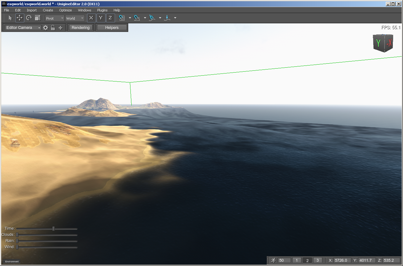

demostenes Posted October 24, 2015 Posted October 24, 2015 Here is screenshot, water is copying bottom of the ocean from some angles: http://screens.endor.cz/_soukrome/demo/water.png
necris Posted October 26, 2015 Posted October 26, 2015 Hi, Jirka Here is screenshot, water is copying bottom of the ocean from some angles: http://screens.endor.cz/_soukrome/demo/water.png Yes, it's a known issue. Fix will be available with the nearest SDK update. Thank you for report!
