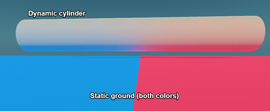

Rahnir Posted June 11, 2021 Author Posted June 11, 2021 Thanks for the pointers and suggestions for improving the scene. Yeah Unity seems to work fundamentally different in regards to light probes. Having it their way has some benefits (like avoiding placement inside geometry). However, with such a system there's also some limits. I created this very simple scene in Unigine: In Ungine, the light probes affecting the dynamic cylinder works out of the box. In Unity, this would not work since each object is affected by a single light probe (in this case it would probably turn purple since it's between red and blue). For large objects (such as this cylinder), that would not be good since the ambient lighting is so different across the object. However, they offer something they call Light Probe Proxy Volume (LPPV), which is a 3D texture created at runtime which samples the light probes at each point in the volume (with user authored density). That way, an object could be affected by multiple probes at runtime, while those probes still being user authored. I think such a system could benefit Unigine also. Another approach could be to discard voxels considered "invalid" prior to baking, and propagate values from nearby, valid cells after bake, until all cells are filled. That may be a better and easier solution to implement in Unigine. Anyway, just some thoughts of a Unity game developer who is exploring Unigine for the first time. All the best. 1
