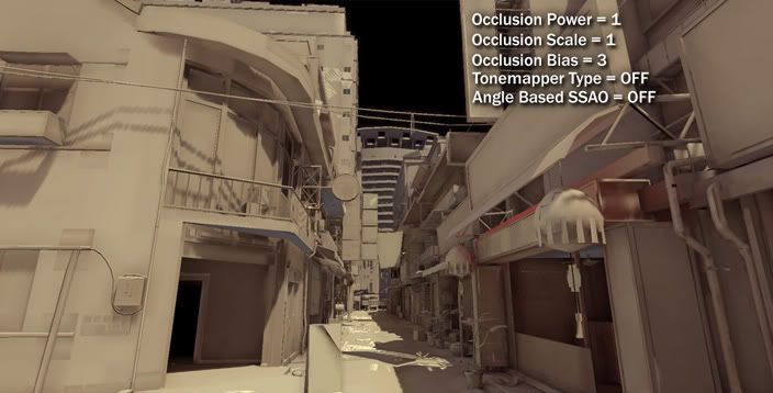

steve3d Posted September 29, 2011 Posted September 29, 2011 unigine use internal occlusion for indirect lighting, but this effects are so expensive, udk and other engine all have a post_ao effect/shader, unigine's current ao is not so good compared to udk's ao ao in UDK: ao in directx sdk's hdao10.1 sample: ao in ungine ( no need to post a sample, everyone here knows the effect) so, after almost two years of using unigine, I never used ao in unigine, so, is there any posible to impove the unigine's ao effect or create a new post_ssao_material?

steve.brodie Posted February 2, 2012 Posted February 2, 2012 I have testing importing a building mesh into the Heaven demo to test the AO settings but the result is very noisy, has lots of banding and doesnt pick up any fine detail. See attached image. Is there anyway to implement an AO solution more like the UDK example steve3d posted. A sample rate slider might be good also if high quality AO is going to impact on speed.

steve.brodie Posted April 4, 2012 Posted April 4, 2012 Battlefield SSAO looks good. We would be really keen to see an update to the current AO process as the current Unigine method does not pick up detail well and has a lot of banding problems. Maybe improve the quality of the current method, or completely rewrite the system with something like Battlefield or Unreal method. We often turn SSAO/SSDO off because it looks too dirty.

manguste Posted November 9, 2012 Posted November 9, 2012 Steve, here are some more screenshots for you.
steve3d Posted November 11, 2012 Author Posted November 11, 2012 Wow really looks better than ever, and, are those noises on walls caused by normal texture?
